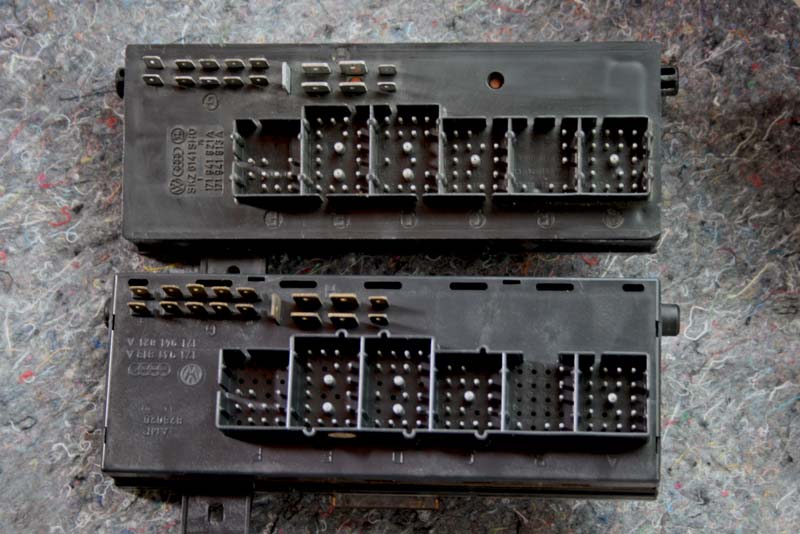

Generalnie - VW Golf, Passat Scirocco "z epoki" a nie żadne tam Porsche. Skrzynka bezpieczników jest z VW Golfa- tylko zmieniono nr katalogowy, logo marki i parę innych pierdół. Nawet elektrycznie są takie same.

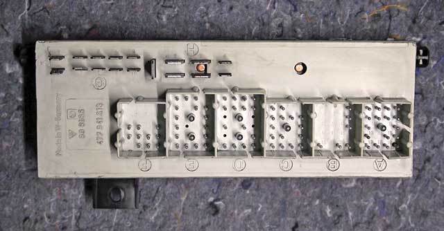

1. Nie ma sprawy. Numery widocznych skrzynek -
VW (formalnie - VW Golf 1):
SKZ6141SHO
171 941 821A
171 941 813A
Porsche:
477 941 813

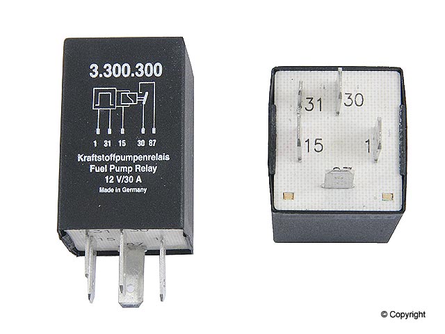

You understood very well. Are you sure these relays are not common ones? I think, that I have above mentioned KAE 3.300.300 which is suitable (according to its specification) to a wide range of cars and models, and I have never had any problems with it.

It's a popular relay used in old VAG cars family. Different manufacturers = different catalogue numbers.
